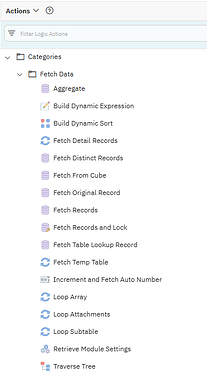

Non-HD structures will initiate or contribute to a DB transaction when they need to make a request to the database, namely a fetch, insert, update, or delete. Other actions run in memory. New with 25.2 is a grouping of logic actions in logic block builder. This list (fetches) mainly consists of actions that will hit the database, with the exception of Fetch Temp Table. Some others have additional nuance or are cached after the first fetch, like Retrieve Module Settings.
