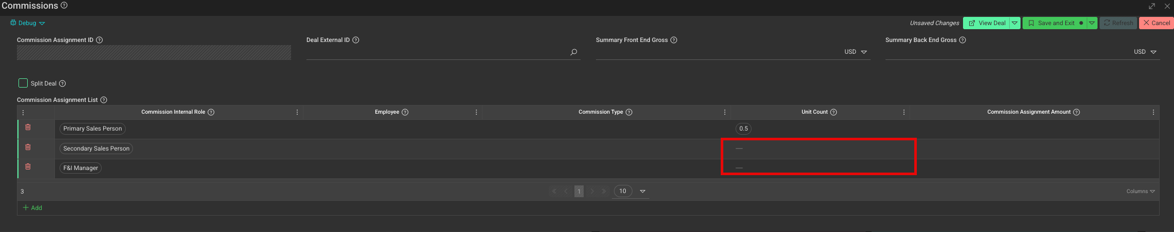

List-lookup values for 0.0 and 1.0 showing as dashes rather than actual values
I’ve created a number data item to keep track of unit counts. I’ve tied it to a list-lookup containing the values/description 0.0, 0.5, and 1.0. When using the dropdown I’m running into a visual glitch of some sort, where only the 0.5 will show correctly. 1.0 and 0.0 will show when first selected, but once I click outside of the record, it disappears and only show as a “–”.
That usually means the value/display name doesn’t exist.
I’ve set both the value and description within the List Lookup Definition. I’ve tried changing the Display setting to show either value or description, both lead to the same issue.
In an attempt to narrow down the problem, I think its an issue with Decimals. I added three more to test, 1.1, and 0.1, and 2.0. 1.1 and 0.1 show fine, however 2.0 ran into the same issue. Seems to be have an issue with showing X.0?
I believe my previous reply was correct, doesn’t seem to allow for a display value of X.0. I changed them both to simply 0 and 1, those display correctly
Hey Damion, that looks like a bug. There shouldn’t be anything special about X.0 values in list lookups.
