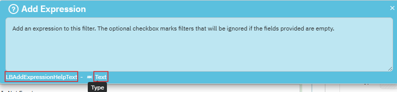

I don’t see a type for the data item. Is there somewhere to locate that information? It’s also not an inline application. As far as I can tell its acts as though it is a table lookup of type text.

If you are working in an application, you can select the ? symbol above a field and then hover over the name in the bottom-left corner of the popup. This will grant you Data Item Name and Data Item Type information, including if it is a related field or other special selection.
You can also utilize the Logic Block Debugger and locate your particular object in the left-hand panel of an active debug session, which will show you any value in the field and indicate its type - ID, text, currency, etc..
Either of the above strategies can indicate what data item and type are necessary and you can declare variables and use other logic actions like Text Manipulation or Loop Array accordingly.
