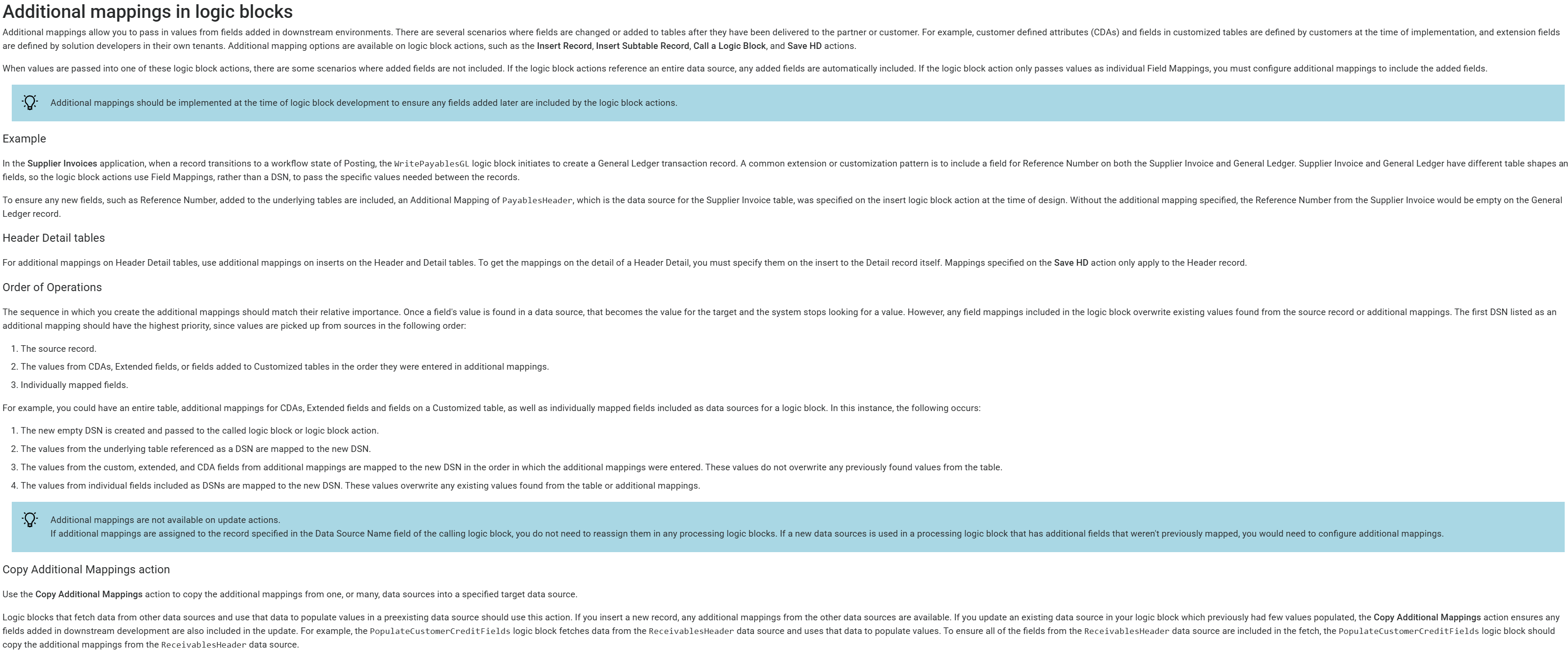

If a Data Source Name is specified when calling another logic block, any extension fields that are populated on the record will pass for free to the called logic block.
If a Data Source Name is not specified when calling another logic block, extension fields must be mapped directly in the Field Mappings, or, using Additional Mappings to pass the extension fields from whatever DSN you specify in Additional Mappings onto the DSN of the target logic block.
Here’s an example where any additional fields on the SalesOrderDetail DSN will automatically get passed to the LB being called:
If it is a pair of base ownership logic blocks involved and you are a customer or partner and don’t have the ability to make changes, to get additional fields to flow between the base logic blocks, the calling logic block must either specify a Data Source Name or if that’s not possible, specify Additional Mappings so that a customer or partners additional fields travel for free from one base ownership LB to another. Nextworld Help gets into more detail on additional mappings per the screenshot below.
