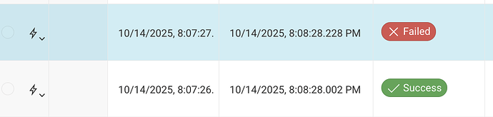

Thank you all for the information. In my case, the failed job has an adoption count of 0. However, somehow I am seeing two background tasks being kicked off within a second apart. So one of the job eventually failed due to timeout on a table lock.
I wonder if it is the way I set up the input/output table for my background task. Here is my setup:

  3. However, if the record is inserted via some integration code, then I see more than 1 background task running within a second. Note that I check the integration table A after seeing multiple background tasks running and I see only one record inserted into table A. That means there should be just one integration request inserting a record into table A.
Here is the submitted and modified datetime and job status:
Ah, sorry, I realize there are two records written to the integration table A for some reason. I think it might be two servers (development and integration) processed the same event and it ended up creating two identical records into table A. Thanks for all your help.
