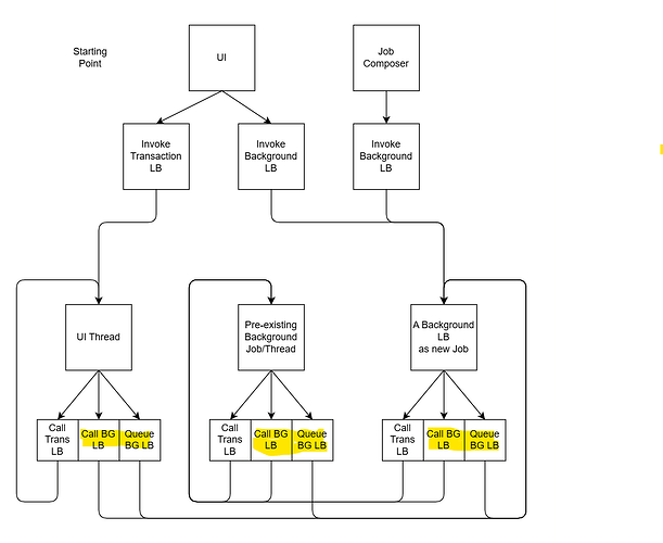

These actions behave differently based on what thread is calling them, and your choice of whether to Call or Queue should be influenced by these design considerations:
  • Queue Background Logic Block will always result in a new job/thread
  • Call a Logic Block of type background will result in
    • a new background job/thread if the initiating thread is a UI thread executing a type = Transaction LB
    • run inline if the initiating thread is a pre-existing background job
Ian’s reply is spot on. Here is some alternate phrasing if it helps:
Queue a Background Logic Block will always queue up the specified logic block to run in a separate background process. It provides the additional “Queue Immediately” checkbox that [may] specify behavior specific to queueing.
For Call A Logic Block, the difference arises based on where the calling logic block is running:
  • If the calling logic block is running synchronously (e.g. as part of a Field Value Changed action), the called logic block will be queued to run in the background.
  • If the calling logic block is running asynchronously (e.g. as a Job or part of an automatic Workflow transition) then the called logic block will run in-line, since it is already in the Background.
@ian.p + @brendan.b, thanks to the explanations and a nice picture; it is worth a thousand words.
