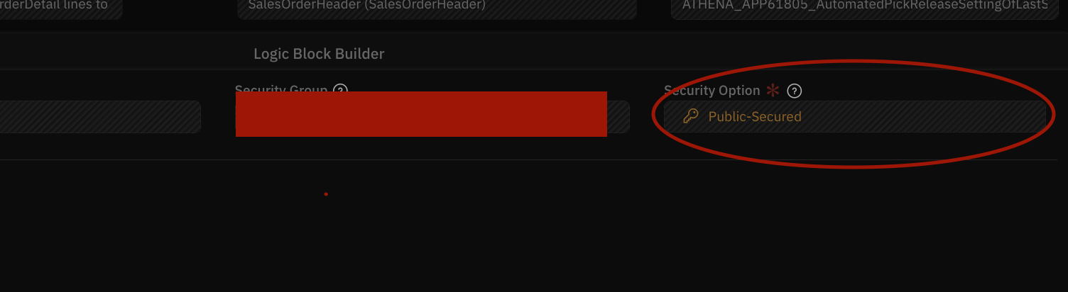

Typically when we run into this when logic blocks are called in we’ll say “unexpected” flows its often the initiating logic block’s Security Option which is being restrictive on the table inserts.
Can you confirm whether the Flow you are kicking off uses a Public or a Public Secured value on the Logic Block config? This is on the very first logic block in the call stack

Hi Aaron! One of the parent LB’s was public-secured so let me try changing that. The funky thing is this was working for the past two days and just starting hitting this error.
I have updated the LBs to all be public and am still hitting the same issue unfortunately.
I wouldn’t suggest changing the Option just to fix an error. Public Secured is going to be the least restrictive option so if that is for certain the Primary or Initiating Logic Block’s option, we need to look elsewhere for your solution.
