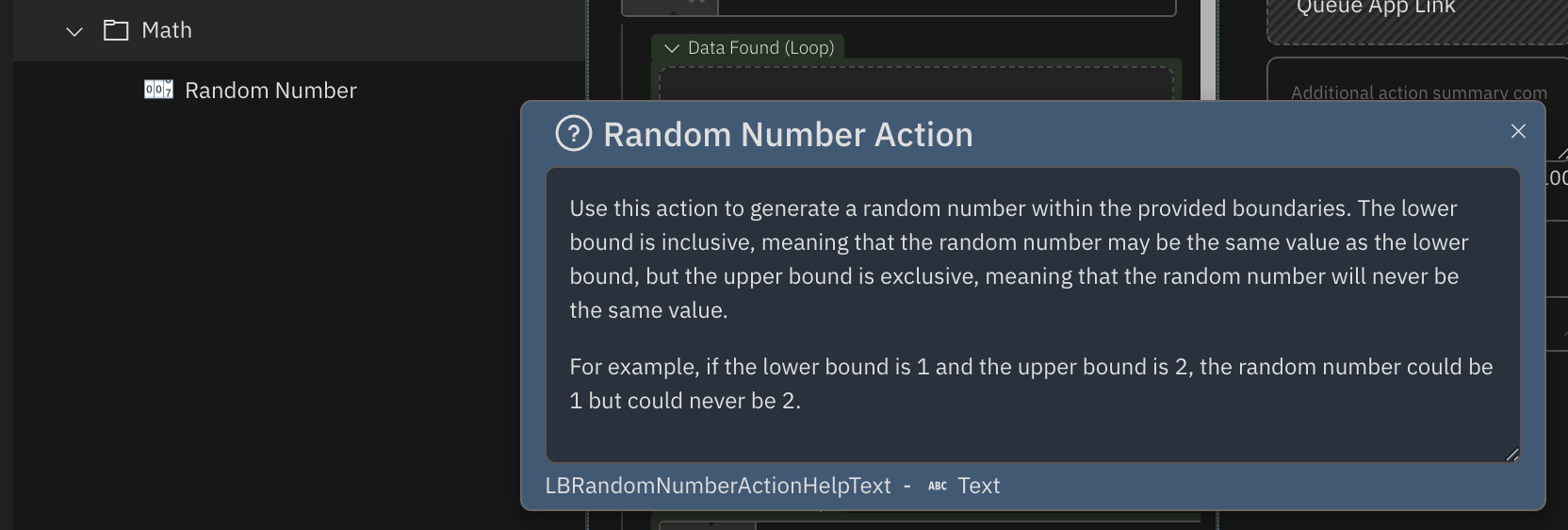

We have a use case we are trying to solve for where a user is randomly prompted (to start with using a set probability) to fill out a form after saving a record. So I have two questions:
  1. Is there a way to generate a random number (like from a normal distribution) in a logic block or anywhere else?

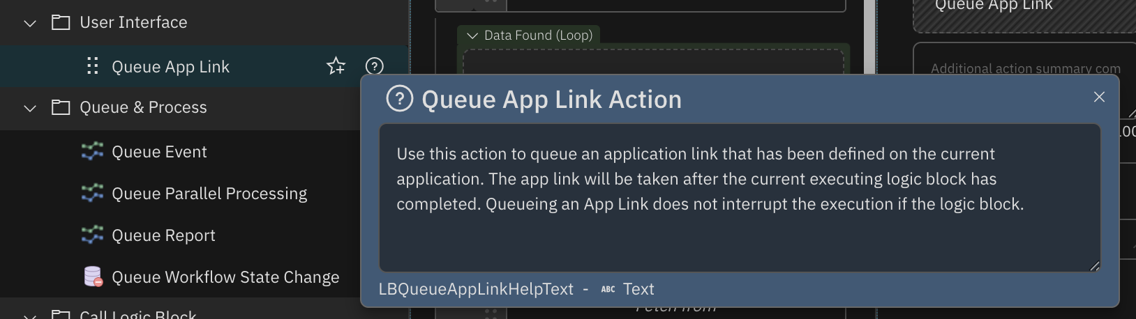

  2. Is there any way to set up an app link which is only followed if a condition is met, and otherwise doesn’t happen? (I suppose a dynamic app link maybe, but in the second case I just want it to follow what the save would normally do depending on the option selected).

  1. There is an action “Random Number” in Logic Blocks. You must define a lower and upper bound.
  2. I’m not sure entirely if this is what you’re looking for but in logic you can use a Queue App Link action to directly send to another application. The app link must be configured in your application.
Thanks Aaron, I’ll take a look at these!
