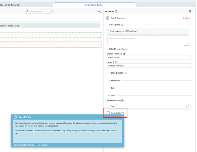

Your other option if you’re fetching a table in the system is to use the Chunk Fetch feature in Fetch Records. This does not let you specify 200 as the chunk size but instead determines an appropriate chunk size for you which optimizes performance. See the help documentation on the “Fetch Record action” for more details.
It’s worth noting that the Loop Conditional solution with a limit and offset may or may not process everything in a single transaction boundary, depending on what each individual fetch needs to accomplish.
Chunked fetching requires that each individual endpoint call out of NW would need to be in its own database transaction. This is better for performance in most cases but might not be applicable to your situation depending on how you need to handle errors and rollback changes.
