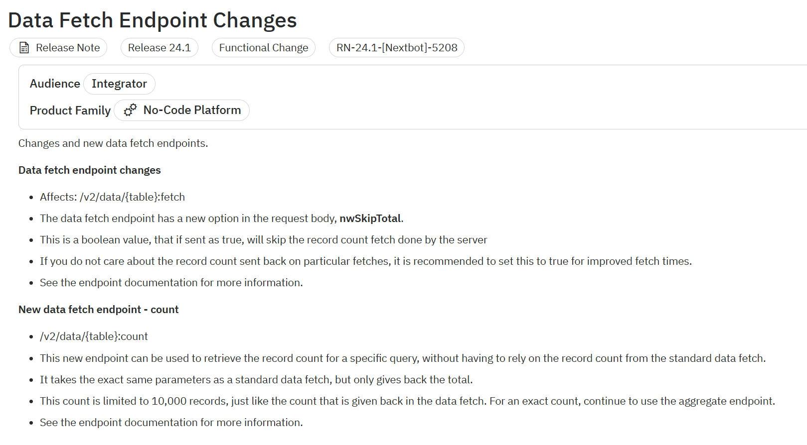

Please can you clarify the use/purpose of nwSkipTotal in API calls, specifically fetches? I am seeing a significant difference in performance when passing true vs false. I have checked the integration documentation, but couldn’t find anything there unless I am looking in the wrong place?
Thank you!
There is a release note from the 24.1 release RN-24.1-[Nextbot]-5208 Data Fetch Endpoint Changes that discusses nwSkipTotal:
Thank you, @ian.p! That helps :slight_smile:
