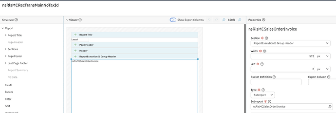

As Jeremy mentioned, layouts on the subreport isn’t supported right now. I was able to get this to work by doing the following:
  1. Copied the SalesOrderInvoice report and removed the TaxId
  2. Created a Report Layout of the Receivables Transaction Main report and pointed the the subreport from the SalesOrderInvoice to the one I copied (namespacedSalesOrderInvoice)

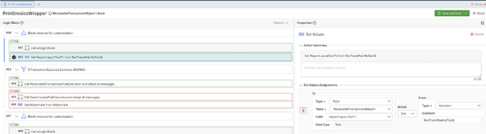

  3. I customized the PrintInvoiceWrapper logic block, and set the ReportLayoutTextTL to the name of the layout I created for the ReceivablesTransactionMain.
