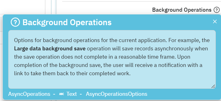

The Background Operations field on an application definition has a value for Large data background save, also known as Asynchronous Save.
This is the field used to indicate that the save action should progress to the background on the API server after its processing exceeds a certain time limit.
I went looking at the PUT requests on a save from an application directly but could not find the information in the request payload. It might well be there but I don’t know exactly where it lives. It would likely be in the request labeled as AsyncOperationsor something similar.

Ross it correct in that via the Platform this setting is only available at the app level, but really it is about how your NATE container is committed. So you actually can use it via REST endpoint calls as well by sending the asyncSave flag = true in the request body when you commit your container.
