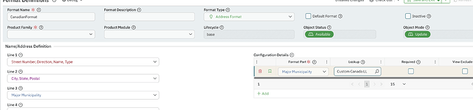

@JamesW Have you tried using either the International Format or Custom Address B format to meet the requirements? If you create a new Format Definition, use the Format Type to connect the format definition to the list of address types available when creating a new address.
The best way to accomplish this is to create a new address format definition. In that new format, you can specify a new custom List Lookup to use with one of the fields in the format.
